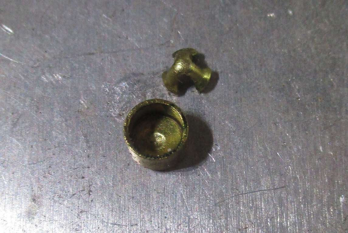

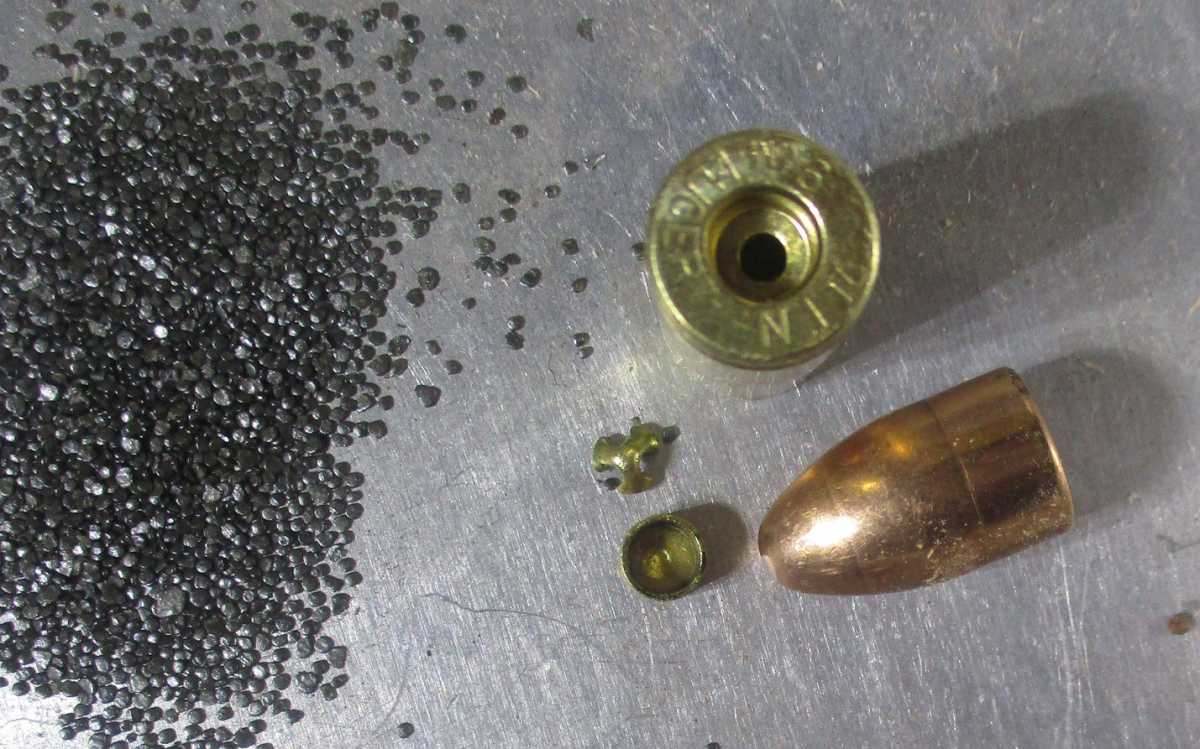

A friend bought some Winchester 9mm ammo
Thursday, August 20, 2020, 06:03 (2053 days ago) @ Huey
We were shooting and he had one that failed to fire. I took it home and pulled the bullet. This is what I found ----
![[image]](images/uploaded/202008201302145f3e74562d3bb.jpg)
The primer had no priming compound in it. Not there is no sign of it being fired.

Never had that happen myself but I have seen it several times.
