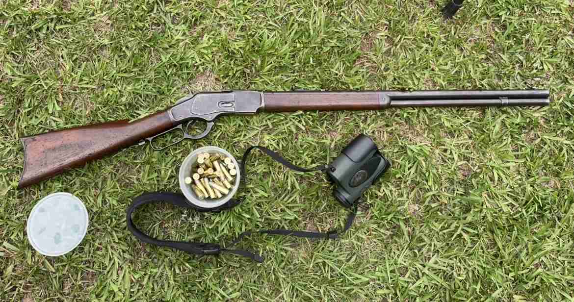

Finally got around to testing my 1873 Winny

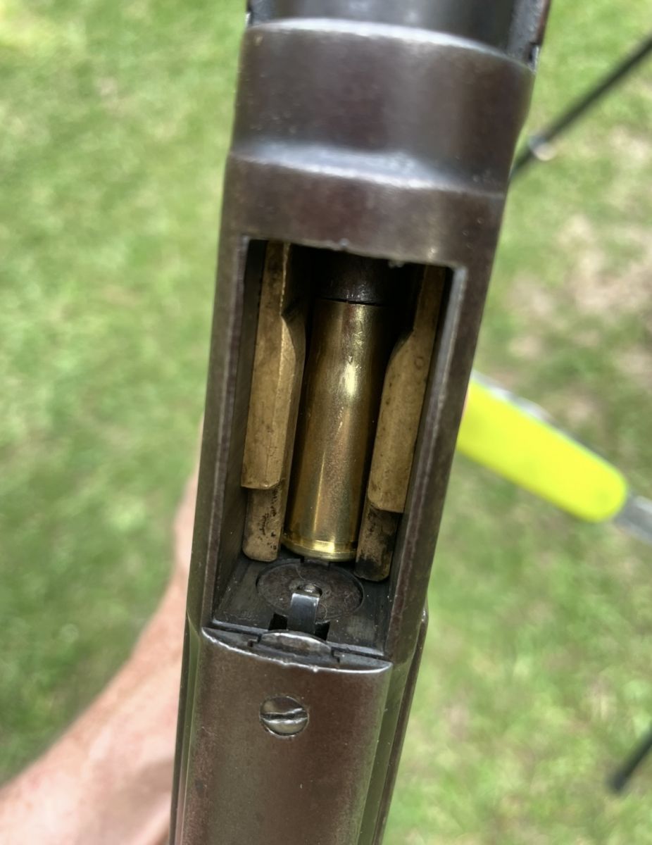

I loaded up some modern 200 gr. FN bullets by reverse engineering some Taffin light loads with Bullseye (4.5 gr.) But I forgot a rookie rule. OAL, just seated to the crimp groove and called it good. Too long, the carrier couldn’t lift, locked up on the OAL at the bottom extractor hook. You CAN unload a 1873 through the loading gate! I did, poked the round back in the tube, lifted the elevator and held the loading gate open, that coaxed out. So I loaded the 140 yr. old levergun single shot. I had not fired it but took a leap of faith, 106 yards feed sack.

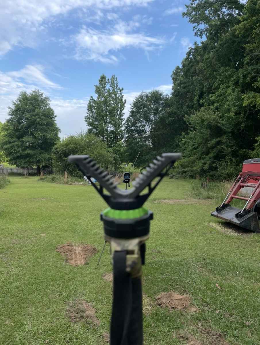

That’s exactly what 106 yds. looks like behind my spectacles.

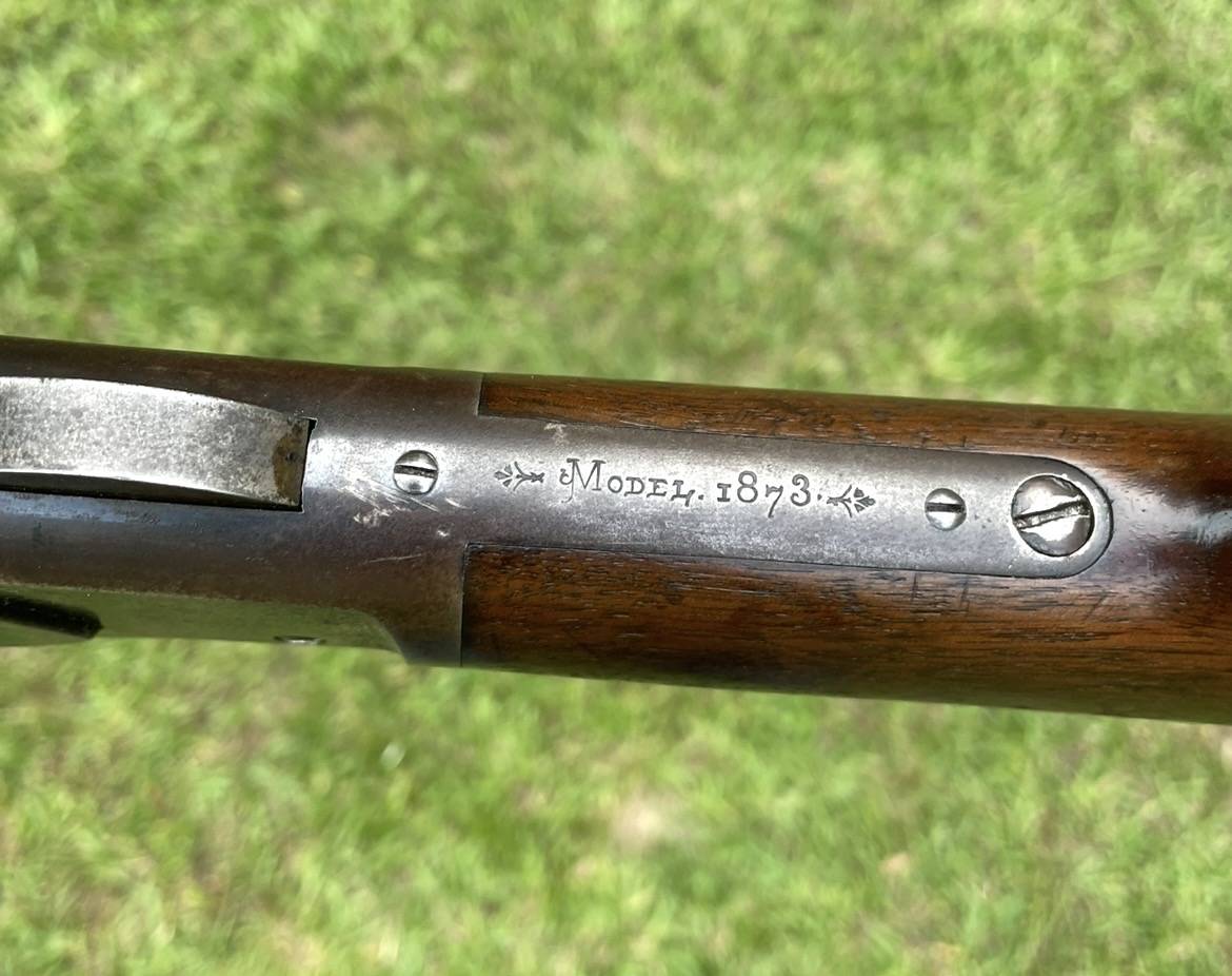

Truly I think the 170-175 SWC is the top dawg for this old platform. It can safely push that north of 1200 fps, just like it did in 1888. But I sure had fun. Love, love the snickity-snick-ting of the toggle link 1873.
I need to research to see if this old gun was tapped for some old tang sights? Those two small plug screws? If so maybe I could find a period one.
