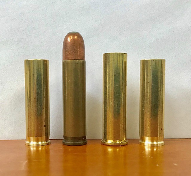

The .401 WSL, one of those strange guns you may pass by at a gun show. Know about, but little interest. They had a whole line beginning in 1905, first a semi-auto version of the .32-20 .(.32 WSL) and .38 Special +P (.35 WSL). Really earth shattering in 1905. 1907 they reworked it into the .351 WSL (.357 Maximum performance) and 1910 the .401 WSL was introduced. It made for a very handy hard hitting carbine. The .351 1907 rifle was popular with law enforcement all the way to 1957. Both the .351 and .401 saw military service in France. Observation balloonist used them for the good firepower and ease of handling in a tight gondola. A 250 gr. bullet at 2000 fps is not far behind the .444 Marlin that came 60 yrs. later! The modern “.400 Legend” is almost a copy of the old .401 either by cunning design, or a totally ignorant accident. The latter would not surprise me at all. I have a nice shooter 1910 Winchester .401 from the 1920’s. I’ve made shootable brass from .41 Remington, .414 Supermag, and 7.62x39. The 6.8 Remington, .30, and .35 Remington brass also can be modified. The .400 legend is a true 10mm so bullets are easy. On the old .401 I use cast oversized .410” bullets, in lieu of the correct .408” sizer.

Perfect brass were formed from rare .414 Supermag Starline cases.

A bit laborsome, two lathe operations are required. Batch making it’s not bad to hear a 100 yr. old hunting rifle go bang again. The blow-back action does not allow a lot of flexibility in loads but it’s easy on the brass.
