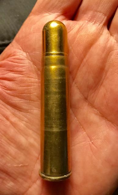

I bought the .476 GNR barrel from Puffy. I have some Barnes 500 gr. bullets for it. That would do about anything with some reserve.
The MIGHTY .476 GNR end all load, a 500 gr. Barnes monolithic solid.
