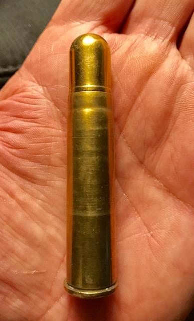

The MIGHTY .476 GNR end all load, a 500 gr. Barnes monolithic solid.
I think the fact that it is an absolutely balls
Friday, March 06, 2026, 07:18 (1 day, 15 hours, 38 min. ago) @ WB
to the wall round and scares a lot of people off. I thought about loading it for my African lion hunt couple of years ago. John (our PH) told me a lion is a thin skinned animal and there were several other cartridges that would do just as well without flattening out your nuts. I think Blake used it on his lion.
The only problem with the 476 GNR is you get one round off and are fighting the recoil of that one round when you need to be sending a second round his way.
The best thing I can say about the 476 GNR is "it works".
