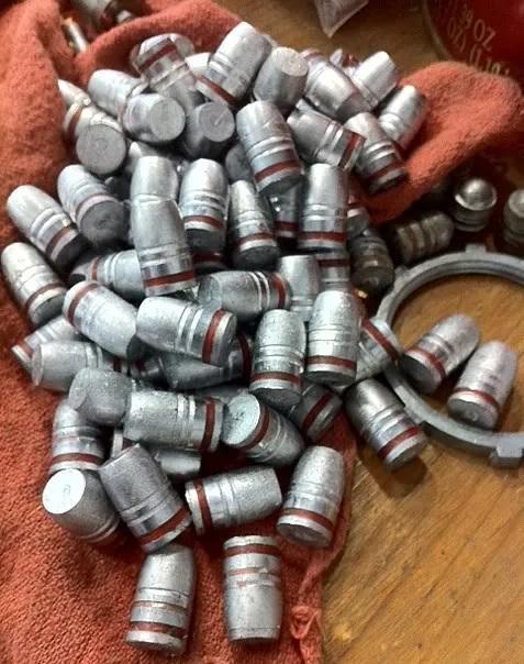

I’m really struggling finding someone who makes a 340-355 grain hard cast lead bullet for reloading my 44 mag. I can buy already loaded ammo from Buffalo bore and such. But I can’t find the bullet or even a mold for a bullet that heavy. Where are these guys getting their bullets from!?

Friday, December 19, 2025, 18:46 (42 days ago) @ Gary Reeder
from my alloy it cast 320 grains. It had a very shallow rounded grease groove and proved to run out of lube easily. Leaded badly at over 1400 fps.
I told him what we ran into and he redesigned it with a larger squared grease groove. That was the 315 gr. mold I believe. My alloy cast less than that by about grains or so. From Linotype they were 285 grains.
MY friend had2 Redhawks, a 5 1/2 with open sights and a 7 1/2" with a scope. It was heavy and nice with heavy loads.
We pushed JD's bullets a bit over 1500 fps from the 7 1/2" Redhawk and from a 10 1/2" Super Blackhawk. Dropping back to 1400 fps made a difference in the feel. Off sandbags, scope-sight, the Redhawk would put 5 shots into 1 1/2" at 50 yards. I watched my friend who owned them shoot a palm size group at 150 yards.
For hunting I dropped the loads back to the mid 1300's. Even that was more than a person really needed. There wasn't much slowing down the big heavy bullet.

I had a large amount of linotype back then, so my bullets came out as about 310 to 320. Like you said my bullets with mostly linotype leaded pretty bad. I used a lot of wheel weights and linotype. In my Smiths it was a good bullet right at 275 to 280. Something about that mold bothered me so I put it on here and sold it. Probably the fact that I had to size them, which I hate.

My notes say it cast right at 305 gr. out of wheel-weight metal and approximately 285 from Linotype.

I’ve had good success with a heavy .444 Marlin mold from Mountain Molds
https://mountainmolds.com/
Best of luck on your project.
