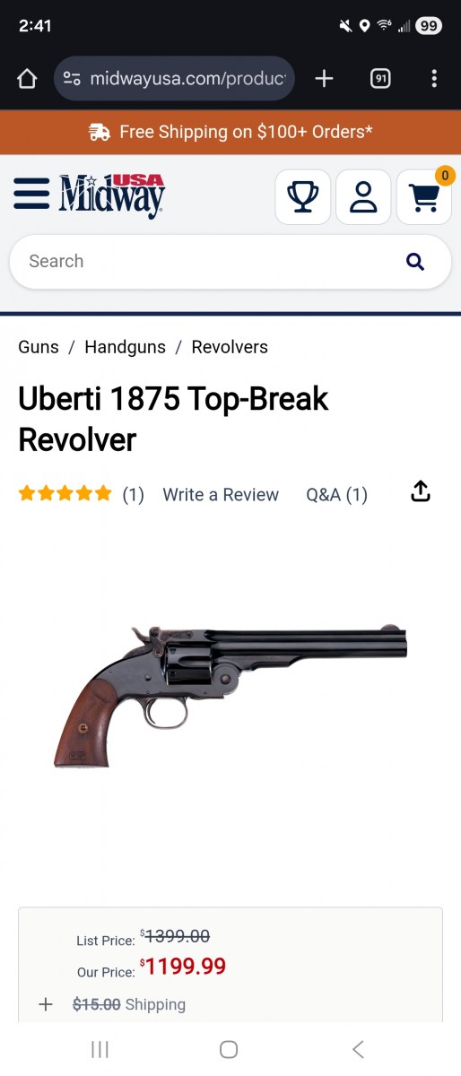

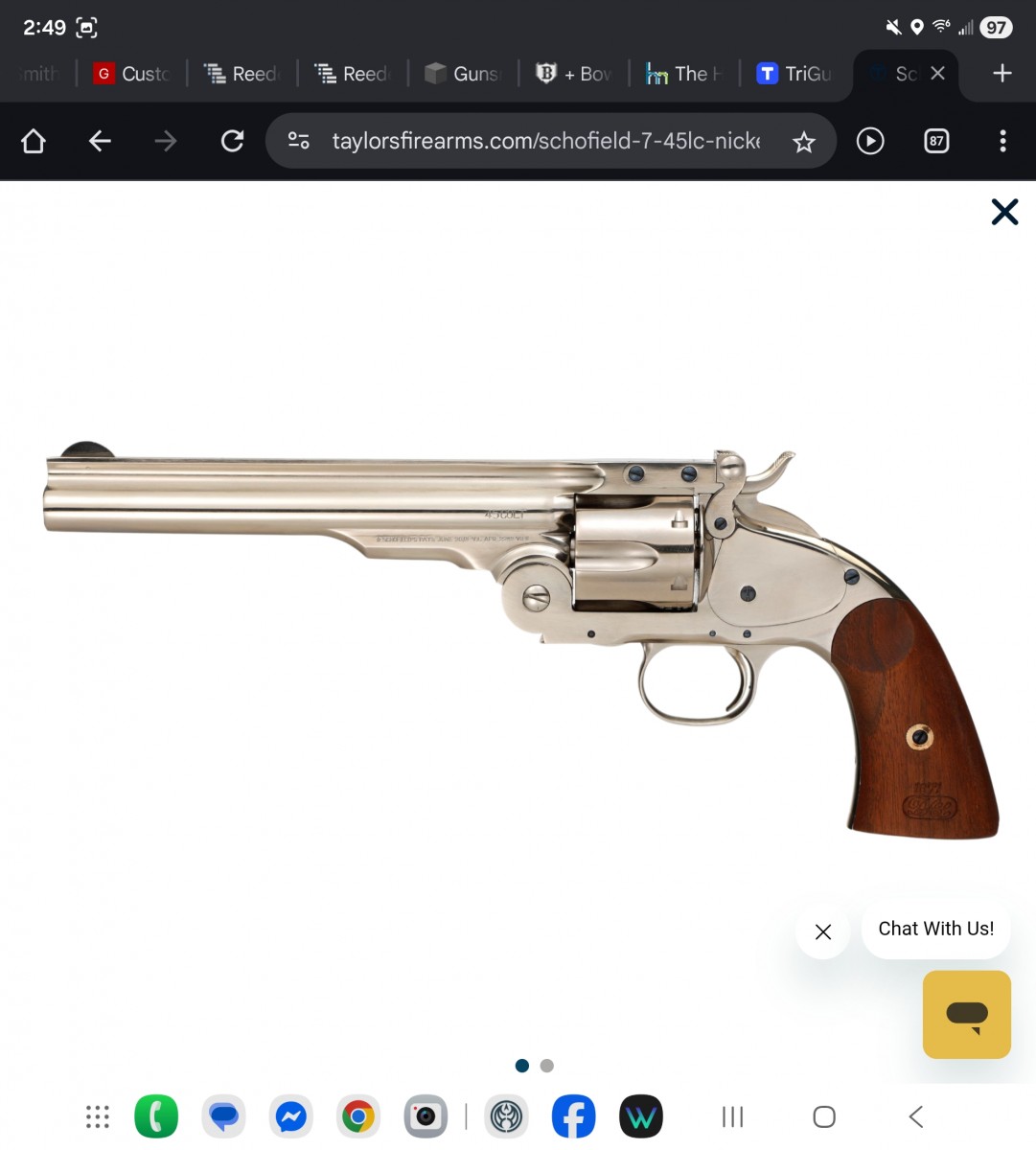

Don't see any Magnum Caliber top breaks. And I would like to have one.
How much work would it take or is it even be possible to make a top break in 454 Casull?
Can the frame be upgraded or would working from the ground up be the better option?

45lc to 454 Casull

It would work for 1 shot, in other words the 454 is HIGH
- Sean Harper, 2025-11-13, 14:19
- Sean is correct. - Jim Taylor, 2025-11-13, 14:53
