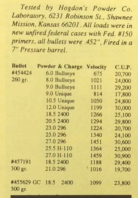

Years back John Linebaugh helped me get .45 Colt loads pressure-tested at Hodgdon's in their pressure barrel. John had built the pressure barrel for them and had access to it whenever they weren't running tests.
![[image]](images/uploaded/202510281313106900c16636087.jpg)
.45 Colt Pressure Data

That's not too scary, considering true Magnum CUP
- WB, 2025-10-28, 09:57
These were all Ruger Blackhawk loads.
- Jim Taylor, 2025-10-28, 10:12
