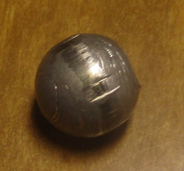

I pushed a .457" ball through the bore. The barrel is extremely slick and smooth with no tight spots of any kind. It has stayed clean with everything I have fired through it so far. No leading at all. I have run bullets #454190.... #454424 .... #457191 ... SSK 270-451 ...and a 225 gr. 45 ACP powder coated bullet through it. None heavier than 18 gr. of 2400.
The bore is 5 groove and measures .4518" near as I can tell.
