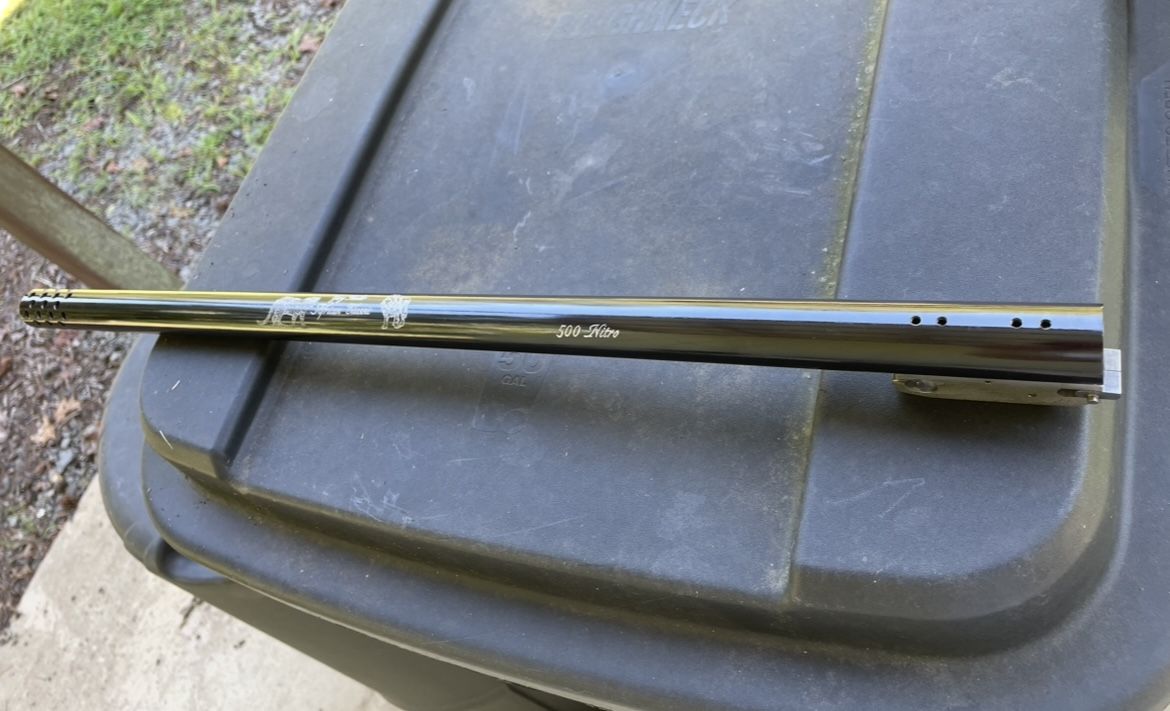

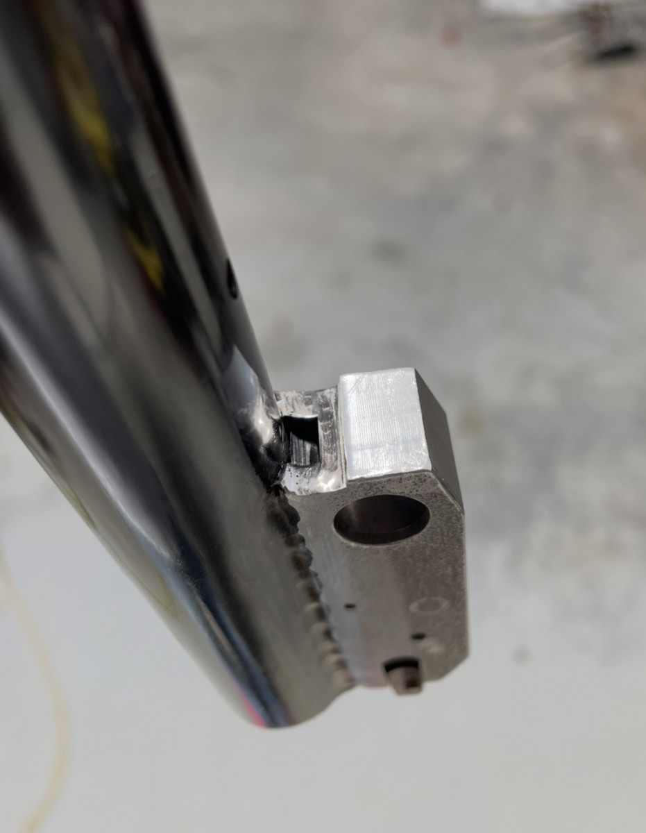

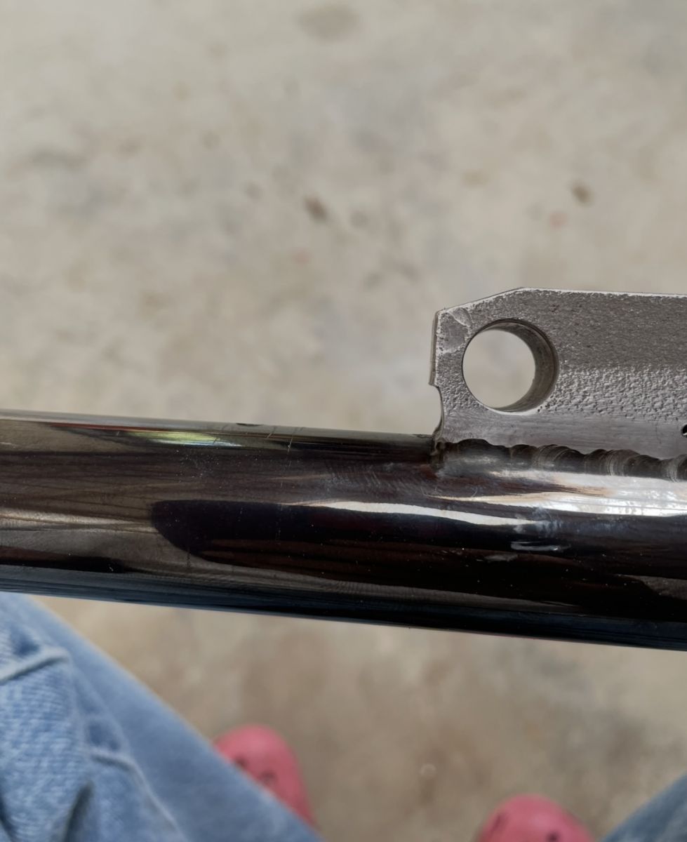

I love the cool barrel and they are pretty rare. My frame had some fittment issues and couldn’t open wide enough to insert cartridges. After MUCH looking and figuring I decided to take a few thousandths off the front of the lug, between the barrel and that shelf. The cam ejector tip lives there too so I was careful. Taped up for protection, hand files were used for precise control. Works fine now.
The tapered barrel rifle forend I have is too small for the full bull barrel. What forends (synthetic) are a better fit? I used a shotgun forend once but it used larger thread screws. I’m not sure I want to drill out, re-tap this barrel.

Nice looking barrel there WB!

My problem was not opening wide enough to clear the chamber. So my frame, it maybe it was the lug about 1mm too thick or forward in a jig. I dunno, but that fixed it. I went a little at a time, checking as I went.
