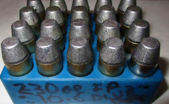

A few weeks ago WB brought up a discussion about using FP bullets for SD. I’m curious, I’ve been using HSTs in my shield. A few weeks ago I saw a video and several others after showing HSTs with great expansion but not a lot of penetration. I also saw that 185gr +p rem golden sabres penetrate really well and expand…but… would a 200 or 230gr FP at 900 be a better all around choice??
Just thinking about changing out my carry ammo… thoughts??

and usually have that for at least my first shot when carrying. I use the 230 gr. flat point.
Talking with guys who were in SOG or other black ops type work, they have all said that the #1 thing they required from their firearms was Reliability. The second thing I was told was they wanted complete penetration no matter the angle of the shot.

that Col. Cooper liked. A 215 grain SWC as I think it was backed by 7.2 grains Unique? That load ought to clock close to 1000fps I bet. A 45 suffers from people not thinking about it outside the "old norms," of what they believed it to be, I run a 250gr +P in some of my 1911s. That's the equivalent of a 45 Colt load. Yes, 22lb recoil spring.

I saw how the riots were unfolding and decided to get FP for possible barrier penetration. Typically, either Hornady 220 +P or a 250gr +P handload. Full size 1911 for those. Jeff Cooper advocated for a FP bullet, as I recall, 230 grains I believe it was.
