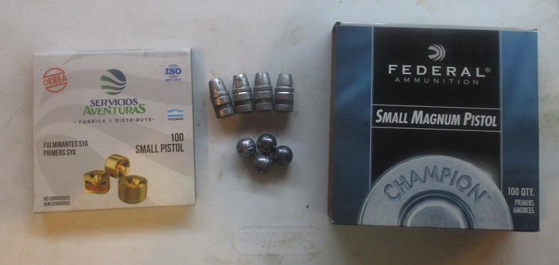

They were a little less than $60 a thousand which these days is a pretty good deal. They were made in Argentina but I decided to take a chance on them. After getting them I figured it would be a good idea to get some kind of comparison to US-made primers so I decided to test them against Federal Small Magnum Pistol primers.

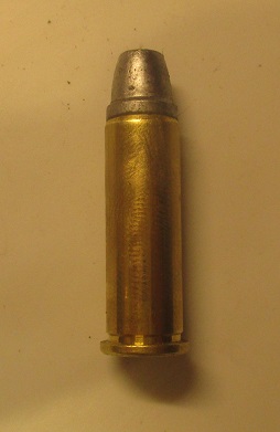

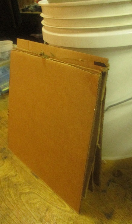

My test was to fire loads with no powder and see how the primers performed. I decided to use the Saeco 158 gr. SWC and a .375" ball. The SWC would be loaded with no crimp and with a crimp. I set up 8 sections of cardboard as a backstop.

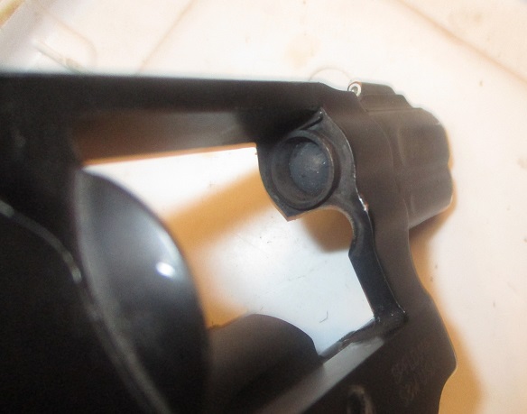

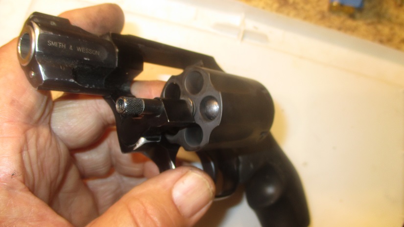

The test would be fired with my S&W Model 340 that has a 1.75" barrel.

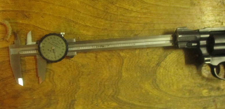

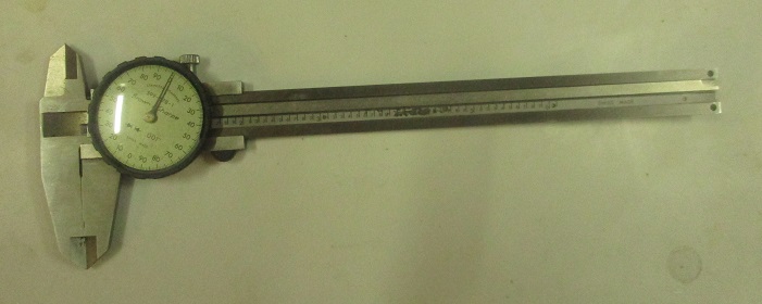

Measurements would be with my Browne and Sharp calipers.

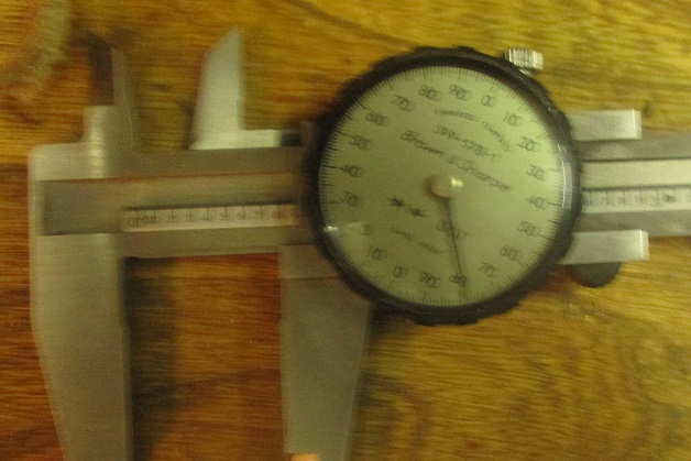

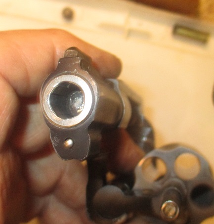

I loaded the Argentine primed, uncrimped load and from a distance of about 6" to the cardboard I pulled the trigger, resulting in a loud POP but nothing exiting the barrel. Then I measured where the bullet stopped in the bore. I apologize for the unfocused photo. I did not pay attention to the camera in my haste.

1.75" minus .78 equals .97" down the bore.

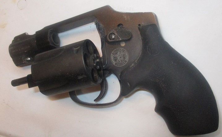

I shoved the bullet out of the bore with a brass rod.

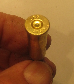

Next I loaded the crimped round. When I pulled the trigger all I got was the CLICK of the hammer dropping. I pulled the cartridge and found the bullet still crimped in place.

Pulling the bullet showed the primer had fired.

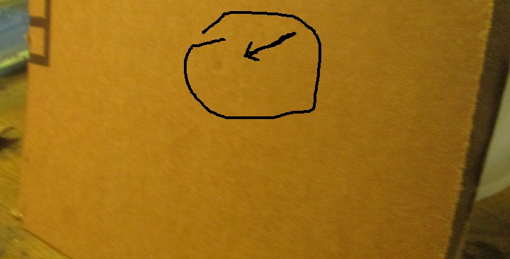

Next I loaded the round ball load and about 6" from the cardboard I pulled the trigger. At the shot the ball hit the cardboard and bounced back onto the floor.

The cardboard had a small dent.

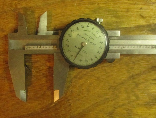

I then took the loads with the Federal Small Magnum pistol primers and tried them. The first was the 158 gr. Saeco SWC uncrimped. It popped the bullet down the bore.
![[image]](images/uploaded/2024082815520266cf47a2cbfa6.jpg)
1.75" minus 1.02" equals .73"
